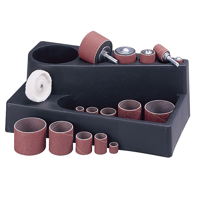

Message alot of tools like the ones below in order:
I used the wire wheel to get rid of the typical oil build up in the plenum. Then once it is cleaned up and there is no oil i would take the grinding stone and smooth out the plunum and smooth out the casting, and while doing that i would smooth out the curves. You can feel how rough it really is and there is dips and "hills" that are just a normal from casting. Once i felt it was smooth enough i follow it up with the sanding disk. They create a nice finish similar to a machined part.
I was in the middle of using my sanding wheels when i ran out i was using a really fine finish i probably should get a rougher finish and work my way to fine as the fine ones are just getting trashed quickly. I hope that helps you out i think i will end up doing the same to the manifold.
